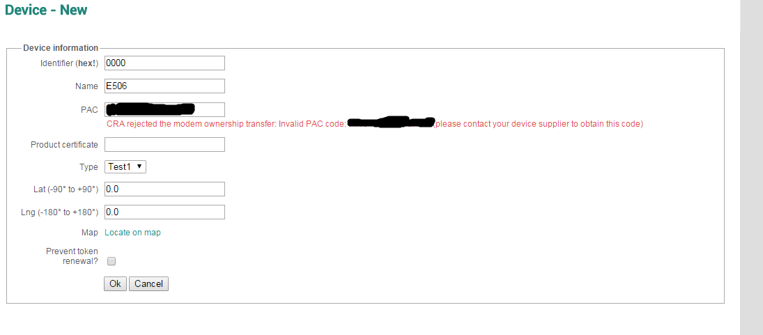

Is it possible to transfer the device to Sigfox cloud ?
I downloaded the PAC from https://developers.insgroup.fr/dashboards/device.html
but there is an error adding the device in the Sigfox cloud:
CRA rejected the modem ownership transfer: Invalid PAC code: XXXXXXXXXXXXXXXX (please contact your device supplier to obtain this code)

I succeed after unregister it first from the application It was attached
