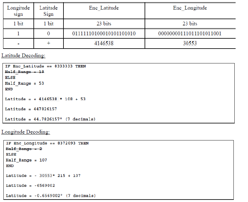

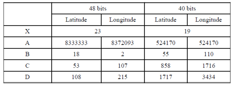

by lcheminade Mon Jul 20, 2015 1:14 pm
Data will be encoded as follow:
Decoding algorithm:
Values:
Example:
0x9fa2b5007759
Loïc
