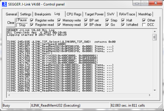

I'm trying to flash a TD1205P module with e-commander and a
error Jlink.PNG (88.61 KiB) Viewed 5577 times
Tiny Geccko board with SEGGER JLINK connection. When trying to remove protection it enters in an endless loop trying to read memory position 400C001C. Does anybody know what could be the reason? Please find attached an screenshot of this issue.
Thank you in advance for any clue.

by mstempin Wed Apr 12, 2017 3:30 pm
When using the eaCommander tool, please make sure that the "Debug Mode" in the main panel is set to "Out" (i.e. the black JTAG connector on top of the board wher ethe TD1205P adapter is attached), not to "MCU" (the internal EFM32 chip on the STK3300 itself, below the LCD screen).
