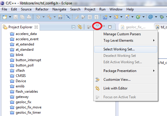

Now , just a thing. After I just finished "Organizing the Sources" , 3
4. Click on the small downwards arrow in the top-right corner of the "Project Explorer" panel and select the "Select Working Sets..." item
5. In the "Select Working Sets" dialog, click on the "Select All", then on the "OK" button
6. Click on the small downwards arrow in the top-right corner of the "Project Explorer" panel again and select the "Top Level Elements > Working Sets" item
I don't understand where is "small downwards arrow in the top-right corner of the "Project Explorer" panel"

lcheminade
Posts: 146
Joined: Mon May 11, 2015 7:47 am
Re: Must be stupid ... how to set eclipse ?
by lcheminade Fri Aug 21, 2015 8:46 am
This is just to allow you to see some specific projects instead of all your project in Eclipse. Not mandatory at all.
