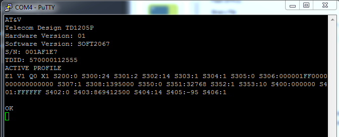

I have loaded the td1205P_modem_SOFT2067.bin firmware with TDloader.exe. I can acces to the device via serial:

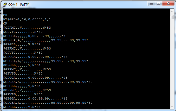

But, when I have tryed to get the GPS signal with the AT command: AT$GPS=1,16,0,65535,1,1 I don't get any information.
also with this command: AT$GPS=1,4,900,180,2,2
I never get any GPGGA response
I don't know what i'm doing wrong, Can anybody helpme?

santiagolopez wrote:But, when I have tryed to get the GPS signal with the AT command: AT$GPS=1,16,0,65535,1,1 I don't get any information.
The hdop can't be zero as dilution of precision won't be null. A value of 500 is quite correct.
The 16 satellites in view may be too much. A value of 4 or 5 is enough.
santiagolopez wrote:also with this command: AT$GPS=1,4,900,180,2,2
Here, the timeout may be too short. The GPS chip requires at least 30 seconds to get a position after a cold start.
If you're testing indoor, geolocation can be very long or might not succeed. You should test outdoor.
Also, the GPS antenna should be upward.

I just have tried in outdoor and the results are the same, I don't get any GPS signal. I only get the time, but not the localization. What am I forgetting?
