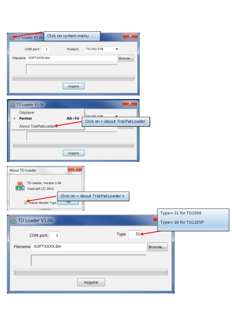

Re: Unable to load firmware to TD1205P with TDLoaderV1.06
by mstempin Wed Apr 12, 2017 3:00 pm
Here is the way to do it:
