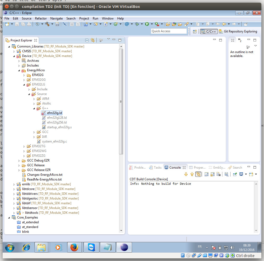

I had the worry that "http://community.td-next.com/viewtopic.php?f=13&t=242&p=877&hilit=core_cm3.h#p877", with "core_cm3.h: No such file or directory" I corrected the problem by opening the project "CMSIS".
I take a screenshoot my workspace.

Re: Problem of compilation
by mstempin Mon Dec 19, 2016 9:04 am
by Archie Mon Dec 19, 2016 1:30 pm
merci mstempin, je n'avais pas réussi à trouver dans le forum.
Ca fonctionne nickel
