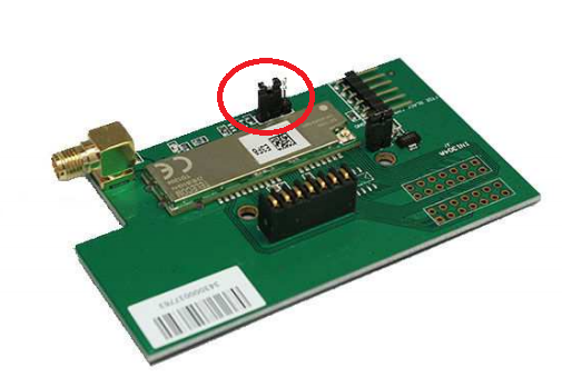

You need to set this header in order to power the GPS:

Problem is partly solved. Everything works with the provided Antenna and another active antenna (Taoglass AP10E). However, we encounter the same error while plugging an FXP.611 from Taoglass. I'm unsure as to why. My guess is that it's because it is passive. Played with the jumper with no luck and din't find any mention of it in the docs. Any idea ?

Not sure why a passive antenna does not work but anyway you need an active antenna to get proper gps performance.
