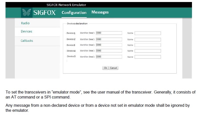

I amtrying to test our device based on TD1508 via a Sigfox Network emulator Mode, but it says I have to use an emulator mode inthe device. Do you have any idea howe to do this on the TD1508?

Hi Ramon,
In order to use the Sigfox SNEK network emulator, you have to use a public key, instead of the standard module private key.
Switching to the public key is achieved by using the following command before sending a Sigfox Frame:
AT$PID=1
This setting is not persistent, so you will have to set it again if you reset the module (this is a temporary test mode).
When using the SDK, the equivalent C API functions is:
bool TD_SIGFOX_SetPublicKey(bool public)
