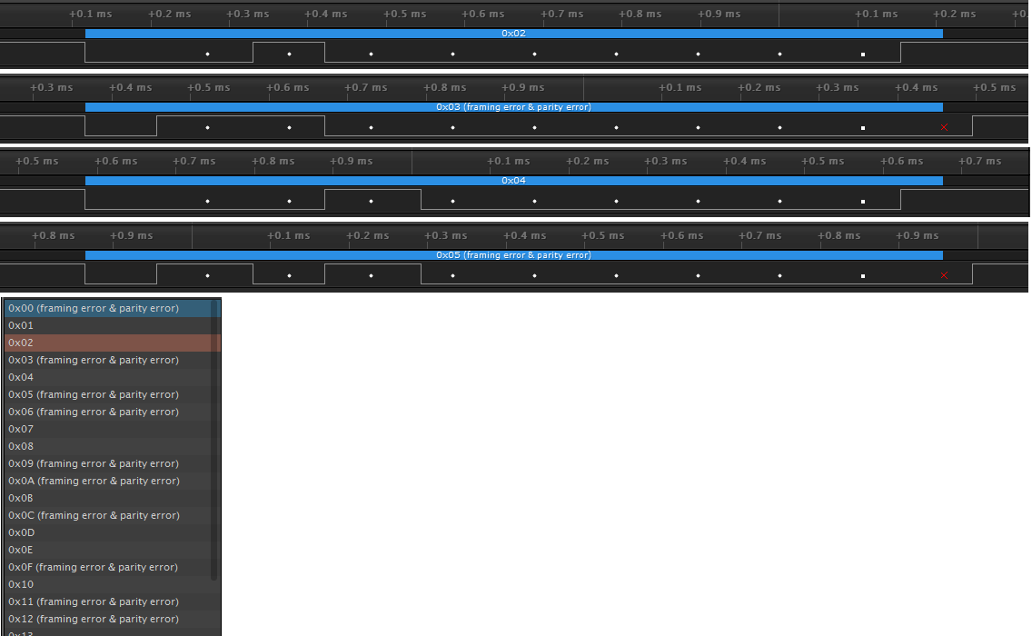

Here below, you can see the results with different configurations for the parity bit. For each parameter, you can see the signal and below a list of some bytes (correct and incorrect)
0 (NO) parity,
Despite the parity parameter sets at 0, the TD1204 still adds an EVEN PARITY bit.
(you can see which byte is displayed above each graphs, in the blue strip)
Parity set: "0"
0 parity.png (32.43 KiB) Viewed 7786 times
1 (EVEN) parity
Here, everything works fine
Parity set: "1"
1 EVEN parity.png (22.35 KiB) Viewed 7786 times
2 (ODD) parity
You can see below, the parity bit isn't correctly set for byte with "even count bits set"
Parity set: "2"
2 ODD parity.png (31.64 KiB) Viewed 7786 times
Please note that the TD1204 is going to be placed in an already existing circuit with a non-modifiable firmware. So I cannot change the parity of the other side of the modbus connection.
Would you have a solution ?
Thank you,
