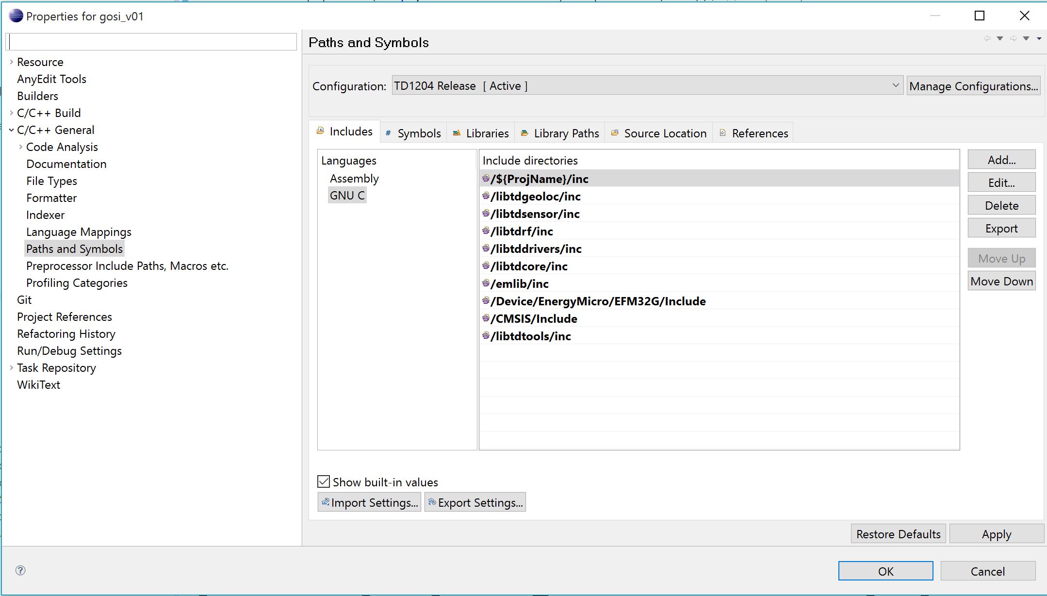

This are the paths in the project for eclipse under GNU C:

Basically, I need a way to use both TD_Geoloc/TD_Accelero and TD_Tools on the same project. I've been trying to add the paths to the libraries to the project settings but it makes no effect.
Any Ideas?
