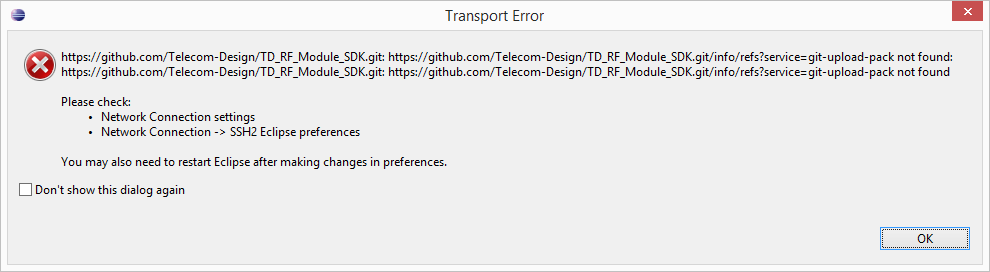

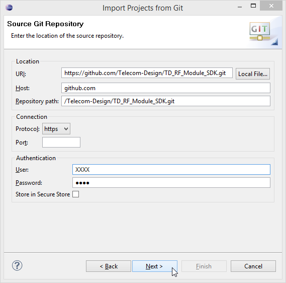

I've followed "Getting the Sources" of the documentation "README.md" but I've a "Transport error" after the following step: "6. Enter your Github username and password in the `"User:"` and `"Password:"` fields, respectively and click on the `"Next >"` button".
I don't know where is the mistake.
To illustrate the issue you will find the screenshot before the error and the error message displayed.

User and password are not valid only for the screenshot

lcheminade
Posts: 146
Joined: Mon May 11, 2015 7:47 am
Re: Fail to get sources from GitHub
by lcheminade Sat Jun 20, 2015 3:01 pm
Are you using a vpn or a proxy of any kind? Anyway you can try a checkout using TortoiseGit or simply download the zip file on Github via your browser then file -> import -> project from git -> local in eclipse.

h4d1
Posts: 4
Joined: Sat Jun 20, 2015 1:56 pm
by h4d1 Mon Jun 22, 2015 5:00 am
No, I've Internet via a direct access. No proxy nor VPN.
I'm using Windows 8.1 but I think there is no link.
I've installed "ToirtoiseGit" but I fail with "Git Clone" and I don't see in GitHub the repository "TD_RF_Module_SDK" with my Web browser (Firefox).
It' like "https://github.com/Telecom-Design/TD_RF_Module_SDK.git" doesn't exist.
Maybe I miss something.
Is there a step to associate my GitHub account to "https://github.com/Telecom-Design" in order to be able to access more ?
Thanks

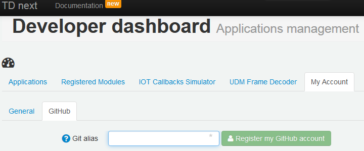

nestorayuso
Posts: 6
Joined: Thu May 07, 2015 12:48 pm
Location: Spain
by nestorayuso Mon Jun 22, 2015 7:28 am
go to https://developers.insgroup.fr/dashboards/developer.html
create an account and link it to your github account.
now you can access the repository https://github.com/Telecom-Design/TD_RF_Module_SDK
h4d1
Posts: 4
by h4d1 Tue Jun 23, 2015 5:02 am
Thank you nestorayuso.
It's sure it was missing !
I've filled "Git alias" with my "Git username" and clic "Register my GitHub account".
It has been ok :)
Developer dashboard.png (18.46 KiB) Viewed 3034 times
Unfortunately problem stays the same: Eclipse, ToitoiseGit or directly with Firefox connected to GitHub with my account it's not possible to retrieve "TD_RF_Module_SDK" repository.
Is there another step I miss ?
h4d1
Posts: 4
by h4d1 Tue Jun 23, 2015 6:31 am
In fact, link procedure is in two steps.
Second one is to join Telecom Design via a link received by email.
Now all is ok , I've imported "TD_RF_Module_SDK" in Eclipse :)
