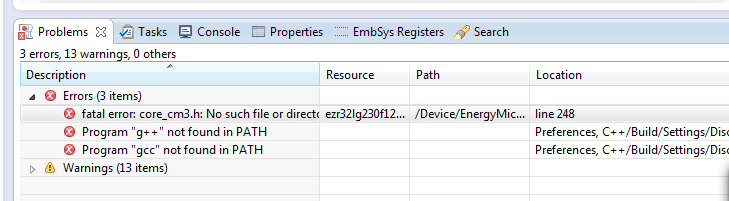

I've received a one sample of the TD1205P and I'm installing the eclipse with the SDK version 6.0.0
I've been trying to compiling a blink example with the toolkit installed as it's explain in the Doccumentation but i get some errors. Below you can see an image with the errors that i've get.

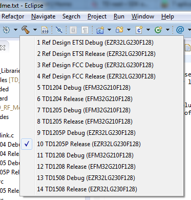

I choose the build TD1205P release.
Can anyone help me please?
In advance, Regards.
Santiago.
Re: Using eclipe with SDK-6.0.0
by mstempin Thu Feb 09, 2017 2:14 pm
Please check the README.html file at the SDK root, it looks like you don't have the compiler in our PATH (Eclipse setting).
