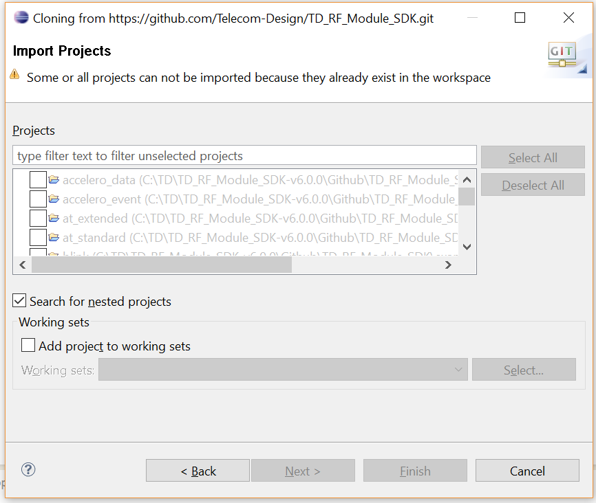

So I tried to go from SDK 4 to the latest SDK 6. I zipped the previous folder C:\TD (and deleted it. I then unzipped the new TD folder so it would take the place of the previous one.
When I tried to import projects, I followed every steps in the README until this happened (see attached image). It says:
Some or all projects can not be imported because they already exist in the workspace
I can't do anything else (except going Back).
Whan should I do ?

UPDATE:
When I delete the contents of folder
C:\TD\TD_RF_Module_SDK-v6.0.0\workspace\.metadata\.plugins\org.eclipse.core.resources\.projects
before Importing from Git, it works.

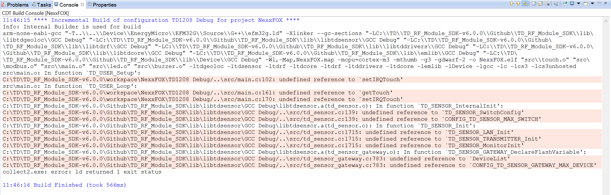

But then when I compile my personnal project (which used to work in SDK4), I get following errors in Console:
Code: Select all
11:46:15 **** Incremental Build of configuration TD1208 Debug for project NexxFOX ****
Info: Internal Builder is used for build
arm-none-eabi-gcc "-T..\\..\\Device\\EnergyMicro\\EFM32G\\Source\\G++\\efm32g.ld" -Xlinker --gc-sections "-LC:\\TD\\TD_RF_Module_SDK-v6.0.0\\Github\\TD_RF_Module_SDK\\lib\\libtdgeoloc\\GCC Debug" "-LC:\\TD\\TD_RF_Module_SDK-v6.0.0\\Github\\TD_RF_Module_SDK\\lib\\libtdsensor\\GCC Debug" "-LC:\\TD\\TD_RF_Module_SDK-v6.0.0\\Github\\TD_RF_Module_SDK\\lib\\libtdrf\\GCC Debug" "-LC:\\TD\\TD_RF_Module_SDK-v6.0.0\\Github\\TD_RF_Module_SDK\\lib\\libtddrivers\\GCC Debug" "-LC:\\TD\\TD_RF_Module_SDK-v6.0.0\\Github\\TD_RF_Module_SDK\\lib\\libtdcore\\GCC Debug" "-LC:\\TD\\TD_RF_Module_SDK-v6.0.0\\Github\\TD_RF_Module_SDK\\lib\\emlib\\GCC Debug" "-LC:\\TD\\TD_RF_Module_SDK-v6.0.0\\Github\\TD_RF_Module_SDK\\lib\\Device\\GCC Debug" -Wl,-Map,NexxFOX.map -mcpu=cortex-m3 -mthumb -g3 -gdwarf-2 -o NexxFOX.elf "src\\touch.o" "src\\modbus.o" "src\\main.o" "src\\led.o" "src\\buzzer.o" -ltdgeoloc -ltdsensor -ltdrf -ltdcore -ltdrf -ltddrivers -ltdcore -lemlib -lDevice -lgcc -lc -lcs3 -lcs3unhosted
src\main.o: In function `TD_USER_Setup':
C:\TD\TD_RF_Module_SDK-v6.0.0\workspace\NexxFOX\TD1208 Debug/..\src/main.c:102: undefined reference to `setIRQTouch'
src\main.o: In function `TD_USER_Loop':
C:\TD\TD_RF_Module_SDK-v6.0.0\workspace\NexxFOX\TD1208 Debug/..\src/main.c:161: undefined reference to `getTouch'
C:\TD\TD_RF_Module_SDK-v6.0.0\workspace\NexxFOX\TD1208 Debug/..\src/main.c:170: undefined reference to `setIRQTouch'
C:\TD\TD_RF_Module_SDK-v6.0.0\Github\TD_RF_Module_SDK\lib\libtdsensor\GCC Debug\libtdsensor.a(td_sensor.o): In function `TD_SENSOR_InternalInit':
C:\TD\TD_RF_Module_SDK-v6.0.0\Github\TD_RF_Module_SDK\lib\libtdsensor\GCC Debug/..\src/td_sensor.c:139: undefined reference to `TD_SENSOR_SwitchConfig'
C:\TD\TD_RF_Module_SDK-v6.0.0\Github\TD_RF_Module_SDK\lib\libtdsensor\GCC Debug/..\src/td_sensor.c:139: undefined reference to `CONFIG_TD_SENSOR_MAX_SWITCH'
C:\TD\TD_RF_Module_SDK-v6.0.0\Github\TD_RF_Module_SDK\lib\libtdsensor\GCC Debug\libtdsensor.a(td_sensor.o): In function `TD_SENSOR_Init':
C:\TD\TD_RF_Module_SDK-v6.0.0\Github\TD_RF_Module_SDK\lib\libtdsensor\GCC Debug/..\src/td_sensor.c:1715: undefined reference to `TD_SENSOR_LAN_Init'
C:\TD\TD_RF_Module_SDK-v6.0.0\Github\TD_RF_Module_SDK\lib\libtdsensor\GCC Debug/..\src/td_sensor.c:1715: undefined reference to `TD_SENSOR_TRANSMITTER_Init'
C:\TD\TD_RF_Module_SDK-v6.0.0\Github\TD_RF_Module_SDK\lib\libtdsensor\GCC Debug/..\src/td_sensor.c:1715: undefined reference to `TD_SENSOR_MonitorInit'
C:\TD\TD_RF_Module_SDK-v6.0.0\Github\TD_RF_Module_SDK\lib\libtdsensor\GCC Debug\libtdsensor.a(td_sensor_gateway.o): In function `TD_SENSOR_GATEWAY_DeclareFlashVariable':
C:\TD\TD_RF_Module_SDK-v6.0.0\Github\TD_RF_Module_SDK\lib\libtdsensor\GCC Debug/..\src/td_sensor_gateway.c:783: undefined reference to `DeviceList'
C:\TD\TD_RF_Module_SDK-v6.0.0\Github\TD_RF_Module_SDK\lib\libtdsensor\GCC Debug/..\src/td_sensor_gateway.c:783: undefined reference to `CONFIG_TD_SENSOR_GATEWAY_MAX_DEVICE'
collect2.exe: error: ld returned 1 exit status
11:46:16 Build Finished (took 566ms)
I've checked my PATH settings and it looks fine to me
PATH =
C:\TD\TD_RF_Module_SDK-v6.0.0\gnu\bin;C:\TD\TD_RF_Module_SDK-v6.0.0\gnu\arm-none-eabi\bin
(otherwise, I assume there would be more errors)
Does anyone has a fix or any idea ?

Delete workspace folder in C:\TD\TD_RF_Module_SDK-v6.0.0 might help you. Then you will have to configure Eclipse again (from the beginning)

dandavid3000 wrote:Delete workspace folder in C:\TD\TD_RF_Module_SDK-v6.0.0 might help you. Then you will have to configure Eclipse again (from the beginning)
Thank you for your answer.
I tried deleting the workspace folder (and also just its content). I could successfully import sources from Git but then I got the same problem as described in the second post.

OK finally got it to work !
What I did:
- Delete previous C:\TD folder (with SDK4)
- Downloaded and unzipped the new folder for SDK6
- Before first execution of eclipse.exe, I deleted the content of workspace
- Launch eclipse.exe
- Import sources for Git, import Working Sets
- Configure PATH: Properties of project > C/C++ Build > Environnment > Add > Path: C:\TD\TD_RF_Module_SDK-v6.0.0\gnu\bin;C:\TD\TD_RF_Module_SDK-v6.0.0\gnu\arm-none-eabi\bin
- Then try to Build every single thing there is (no such thing as overkill lol)
I only saved the folder inc and src of my already existing project. So to import it in Eclipse, I
- Copied the project sigfox (RF_Examples), made sure it still compiled,
- Created a new personnal Working Set and added it to it
- Deleted the file sigfox.c and renamed the project
- Created new source files (main.c, ...) and copied the content of my project in it
- Created a folder inc and did the same as previous step (main.h, ...)
- (no overkilling here :p ) Property of this new project > C/C++ Build > Enveironnment > Add > C:\TD\TD_RF_Module_SDK-v6.0.0\gnu\bin;C:\TD\TD_RF_Module_SDK-v6.0.0\gnu\arm-none-eabi\bin
- Build and it worked ...
As I tried almost a hundred times to do this with every variations possible, I still don't know why it worked this time. As dandavid3000 says, you gotta try a few times I guess !
