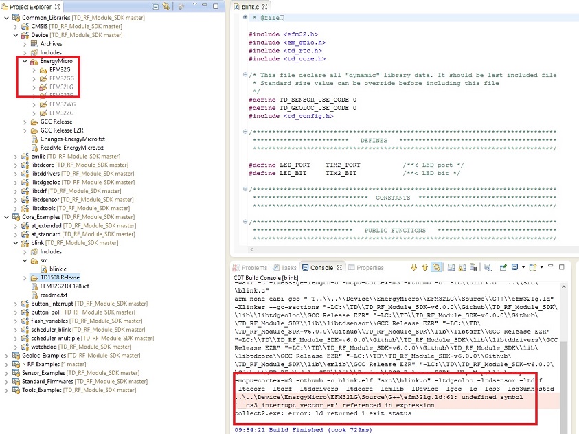

I'm wondering if the new SDK works with TD1508 devices? I tried to build Releases for TD1508 with SDK 6.3.4 and I didn't succeed with examples from the SDK. This was what I did:
- I built new libraries from Commom Libraries
- I set build configuration for blink as TD1508 release
- I also tried to modify GCC C Compiler -> Preprocessor -> REVISION_TD1508
What I see from the picture is they don't have libraries (Devices -> EnergyMicro) for EZR32LG230F128
Do I need to configure something else to solve the problem?
Thank you.

Hi François,
There is a problem related to Windows being unable to distinguish between lowercase and uppercase in filenames under certain circumstances, that cause the file "lib\Device\EnergyMicro\EFM32LG\Source\G++\startup_efm32lg.s" to be named "lib\Device\EnergyMicro\EFM32LG\Source\G++\startup_efm32lg.S".
Please rename this file from "*.s" to "*.S", this should fix the problem!
