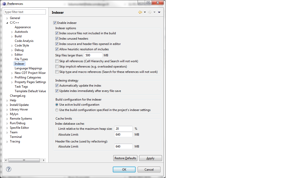

There are a lot of files included in the SDK. So I really need the "open declaration" functionality. But when I press F3 or do it by the right mouseclick nothing happens? How did you guys solve this problem?

paulosz66 wrote:3)
There are a lot of files included in the SDK. So I really need the "open declaration" functionality. But when I press F3 or do it by the right mouseclick nothing happens? How did you guys solve this problem? ,
The "open declaration" feature relies on the project indexer, which is an Eclipse CDT built-in C parser, not using the external gcc/g++ compiler. But you need to set all the corresponding options correctly like below in order for it to work:
Indexer Pereferences
Indexer Preferences.png (74.78 KiB) Viewed 7605 times

The solution you provide for point 3 (Indexer) doesn't work for me. Indexer works fine for CMSIS project, not for others. I think the problem comes from the content of .settings/org.eclipse.cdt.managedbuilder.core.prefs file in each project. In CMSIS project, this file refers to GNU toolchain only and the indexer works. In other SDK projects, the file refers to IAR toolchain also. Since this toolchain is not included in the SDK, indexer can't work.

The solution you suggest for the indexer is not working for me except for the CMSIS project.
I think this is related to .settings/org.eclipse.cdt.managedbuilder.core.prefs file of other SDK projects. There are references to IAR compiler that can't be solved. Could you provide a solution for that?
