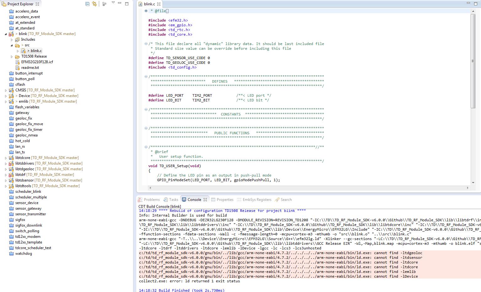

by Farren Fri May 12, 2017 2:47 pm
Screen shot of project
Hi, I had the same problem with this error: Cannot run program "arm-none-eabi-gcc": Invalid directory name. when compiling the blink project
I read this post and followed advice to do a project clean which seems to have fixed the above error but I now get the following errors:
c:/td/td_rf_module_sdk-v6.0.0/gnu/bin/../lib/gcc/arm-none-eabi/4.7.2/../../../../arm-none-eabi/bin/ld.exe: cannot find -ltdgeoloc
c:/td/td_rf_module_sdk-v6.0.0/gnu/bin/../lib/gcc/arm-none-eabi/4.7.2/../../../../arm-none-eabi/bin/ld.exe: cannot find -ltdsensor
c:/td/td_rf_module_sdk-v6.0.0/gnu/bin/../lib/gcc/arm-none-eabi/4.7.2/../../../../arm-none-eabi/bin/ld.exe: cannot find -ltdcore
c:/td/td_rf_module_sdk-v6.0.0/gnu/bin/../lib/gcc/arm-none-eabi/4.7.2/../../../../arm-none-eabi/bin/ld.exe: cannot find -lemlib
c:/td/td_rf_module_sdk-v6.0.0/gnu/bin/../lib/gcc/arm-none-eabi/4.7.2/../../../../arm-none-eabi/bin/ld.exe: cannot find -lDevice
collect2.exe: error: ld returned 1 exit status
Did the clean remove some of the binaries ?
Some of the project folders on the left of the window now have a red cross over the folder.
Any advice will be greatly appreciated.
Thanks.
Re: Troubles compiling
by mstempin Mon May 15, 2017 8:35 am
Please make sure that al lthe required libraries are compiled in the right compilation configuration (it looks like in your case "GCC Release EZR"). You should have a libxxx.a in a subdirectory with the compilation configuration name in each of the corresponding library project.
by Farren Tue May 16, 2017 5:39 pm
Thanks for the advice but it seems that I was selecting the wrong Target, I change to TD 1208, did a clean and recompiled and all worked and binary was generated.
I am progressing well now beyond the blink example and sending SigFox messages.
The instructions to install and get the SDK working are a little confusing and took me some time to work things out. :D
