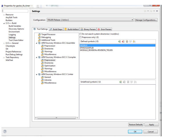

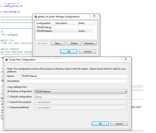

right click -> build configuration -> manage and copy the TD1204 Release configuration into TD1205 Release (same for debug)
Then right click on the project -> properties -> TD1205 release -> C++ Build -> Settings > ARM Sourcery GCC Compiler and rename REVISION_TD1204 into REVISION_TD1205
